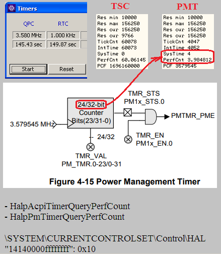

  15. Indy_
    Получается вот что.
    1. typedef struct _KUSER_SHARED_DATA {
    3.     //
    4.     // Current low 32-bit of tick count and tick count multiplier.
    5.     //
    6.     // N.B. The tick count is updated each time the clock ticks.
    7.     //
    9.     ULONG TickCountLowDeprecated;
    10.     ULONG TickCountMultiplier;
    12.     //
    13.     // Current 64-bit interrupt time in 100ns units.
    14.     //
    16.     volatile KSYSTEM_TIME InterruptTime;
    18.     //
    19.     // Current 64-bit system time in 100ns units.
    20.     //
    22.     volatile KSYSTEM_TIME SystemTime;
    1. KeUpdateSystemTime:
    3. ;
    4. ; Update interrupt time.
    5. ;
    6. ; N.B. The interrupt time is updated in a very strict manner so that an
    7. ;      interlock does not have to be used in an MP system to read time.
    8. ;
    10.         mov     ecx,USER_SHARED_DATA    ; set address of user shared data
    11.         mov     edi,[ecx].UsInterruptTime+0 ; get low interrupt time
    12.         mov     esi,[ecx].UsInterruptTime+4 ; get high interrupt time
    13.         add     edi,eax                 ; add time increment
    14.         adc     esi,0                   ; propagate carry
    15.         mov     [ecx].UsInterruptTime+8,esi ; store high 2 interrupt time
    16.         mov     [ecx].UsInterruptTime+0,edi ; store low interrupt time
    17.         mov     [ecx].UsInterruptTime+4,esi ; store high 1 interrupt time
    19.         sub     _KiTickOffset,eax       ; subtract time increment
    20.         mov     eax,_KeTickCount+0      ; get low tick count
    21.         mov     ebx,eax                 ; copy low tick count
    22.         jg      kust10                  ; if greater, not complete tick
    23.
    24. ;
    25. ; Update system time.
    26. ;
    27. ; N.B. The system time is updated in a very strict manner so that an
    28. ;      interlock does not have to be used in an MP system to read time.
    29. ;
    30.
    31.         mov     ebx,USER_SHARED_DATA    ; set address of user shared data
    32.         mov     ecx,[ebx].UsSystemTime+0 ; get low interrupt time
    33.         mov     edx,[ebx].UsSystemTime+4 ; get high interrupt time
    34.         add     ecx,_KeTimeAdjustment   ; add time increment
    35.         adc     edx,0                   ; propagate carry
    36.         mov     [ebx].UsSystemTime+8,edx ; store high 2 interrupt time
    37.         mov     [ebx].UsSystemTime+0,ecx ; store low interrupt time
    38.         mov     [ebx].UsSystemTime+4,edx ; store high 1 interrupt time
    39.         mov     ebx,eax                 ; restore low tick count
    RTC -> HalpClockInterrupt -> KeUpdateSystemTime(). При этом приращение SystemTime + KeTimeAdjustment: CONST.
    InterruptTime + f(HalpClockInterrupt()) ->
    reg."EnableTimerWatchdog" по дефолту не задействован.
    const HalpCurrentClockRateIn100ns
    const HalpCurrentClockRateAdjustment
    var NtSetTimerResolution -> HalpClockSetMSRate/HalpNextMSRate.. etc.
    - логика становится не линейной. Между тем timeGetTime() читает не SystemTime, а InterruptTime:
    1.     mov edx,[7FFE000C]
    2.     mov eax,[7FFE0008]
    Если смещения изменить на SystemTime(7FFE000C -> 7FFE0018 etc), то в cpuz тулзе тайминг не изменяется. Только я проверить не могу, он не плавает на вирте.

  17. Indy_
    xpmod21,
    Походу я понял в чём косяк.
    QPC может выбираться разный, по дефолту tsc, на котором у меня время не бежит. Включаю ACPI таймер, время бежит и кстате это второе прерывание для апдейта часиков, кроме rtc. Дефотный tsc 64 битный, но PMT - 24-х и тайминг переполнения ~4сек. При этом измеряемое timeGetTime() значения от запуска системы, при калибровке через QPC(PMT) накапливается ошибка, замер не должен длиться более нескольких секунд. Это баг в самих приложениях.

  20. Indy_
    f13nd,
    0xffffff/3579545
    xpmod21,
    Потому что в качестве qpc используется 64-бит tsc. На скрине два ISR и параметры внизу написаны.
